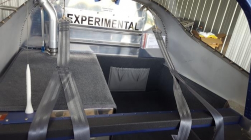

Did final install with velcro of the baggage compartment upholstery. Will install top piece later.
Rear upholstery done
