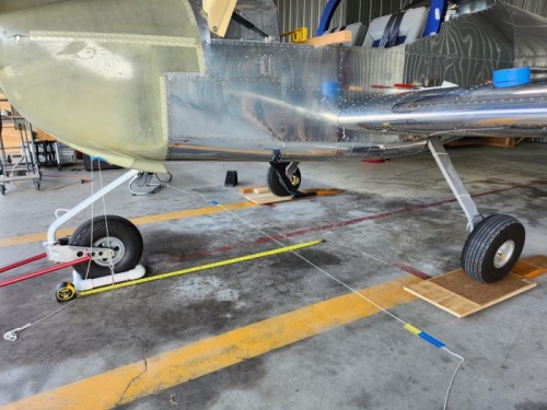

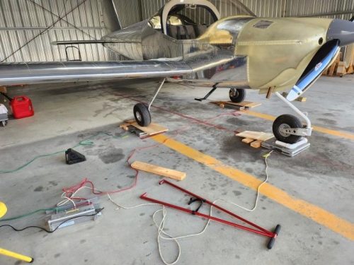

Date:  9-18-2022
Number of Hours:  6.50
Manual Reference:  PAP
Brief Description:  perform weight and balance
Installed both cowlings, installed upholstery temporarily, Prepared for weight and balance measurements. Performed the weight and balance. Measured the distance from the wings and calculated from the Datum. Had to use blocks to get the plane level. See pictures for scales used.
See log books and POH for values calculated
W & B display
W & B display
Measure from datum
Measure from datum
plane on scales
