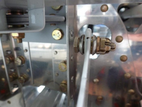

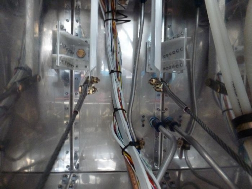

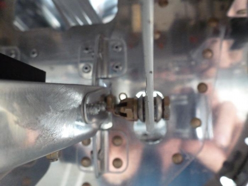

Manual 32-13 step 1 attach rudder cable links and cables to the rudder pedals. Step 6 attach the horizontal stabilator cables. Had to drill the stab horns with #12 to bolts to fit. Also had to loosen the cable turn buckles to get more length to attach the cables.
rudder cable links attached
upper horz. stab. cable
bottom horz. stab. cable
