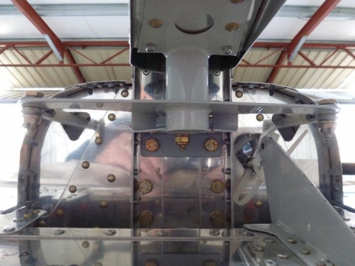

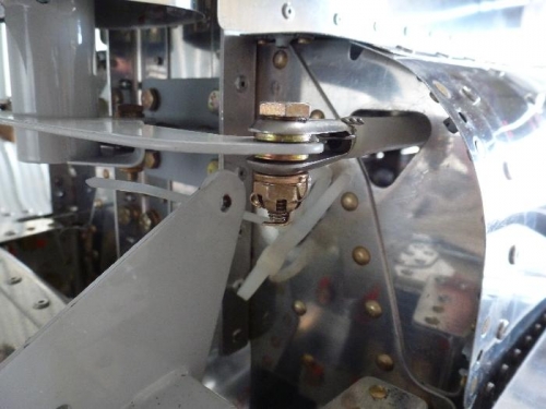

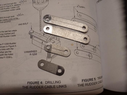

Manual 32-12 steps 3 - 10, fabricated the rudder cable links F-1258-L and R. Marked the cable links first for hole to drill, etc. Used two pieces of particle board on each rudder horn to keep the rudder centered.
Attached the rudder cables to the rudder horns. The links will be used at the rudder pedals.
rudder cables attached
rudder cable attached
