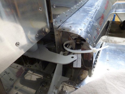

work on rudder cable links
Manual 32-11 step 6 attach rudder cable links to the rudder cables. Marked the cable links first with centerline.

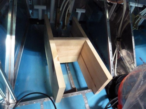

Manual 32-12 steps 1 and 2, set the rudder pedal rigging jig then marked the hole location for the link.
rudder cable link connected
