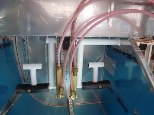

Brief Description:  bleed the brake lines
Manual 35-09 step 2 bleed the brake lines. Used a pump to pressure push the brake fluid into the brake lines via the brake calipers. Called Matco to get help on why the fluid was not flowing at first. Did some troubleshooting to see if there was a clog. Non found, pumped the pressure up and got it to flow into the brake lines. Did this by myself so had to stop many times to see where the fluid was at. Used a white wire tie to dip into the brake fluid reservoir to check the level.
Manual 10-03 tried to tap the rear hold down ring threaded hole to fit the ring in all the way. Came up short by 1/4" screwing it in.
brake fluid in brake lines
