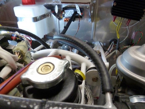

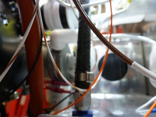

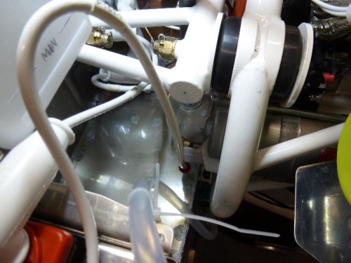

Manual 46-14 steps 1 & 2, connect the power wire to the starter, torqued to 35 in-lbs. connected the starter/engine ground to the starter case, applied NOALOX anti-oxidant joint compound to the hardware and torqued to 70 in-lbs.
Manual 46-15 steps 1 - 3, fabricate FF-1222 manifold pressure sensor hose and connect to the compensating tube and the manifold pressuer sensor. No clamps needed. Wire tie sensor wires to the hose.
man. pressure hose to sensor
starter ground wire
starter ground wire
