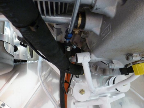

fabricate and install fuel drain hose and tube

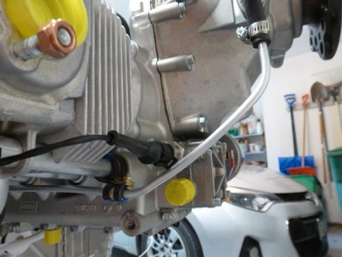

Manual 46-16 steps 1 - 7, fabricate the fuel drain hoses and drain tube. Connect using clamps and cushioned clamps on oil return tubes. Need to wire tie.
fuel drain tube from fuel pump
fuels drain tube/hose
