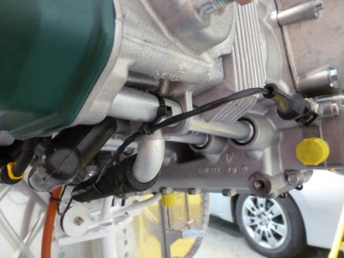

Brief Description:  connect sensors to the engine

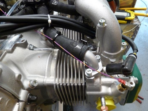

Manual 46-12 steps 6 - 8, finish 5, wire tie the oil sensor wires, connect wires to the left and right CHT sensors, connect wire to the oil temp sensor. Wire tie them all.

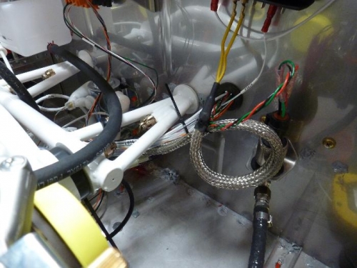

Manual 46-13 steps 1 - 5, connect the generator wire to the voltage regulator and wire tie. Connect Rotax trigger coil wire to connector supplied by Rotax, wire tied but di not tighten. Replaced cushion clamp where the pitot tube and generator cable runs from WDG8 to size WDG12 so all of the wires would fit.
wire to one CHT sensor
wiring from gen. to volt. reg.
oil pressure sensor wiring
