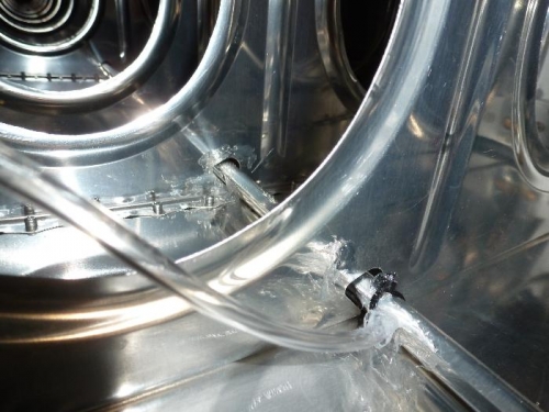

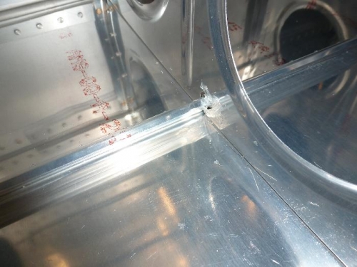

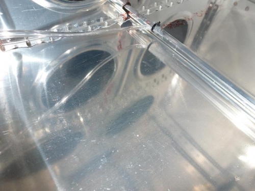

Notification 16-12-14 steps 14 and 15, install tube into wing fitting and install fitting in the left wing. Unable to torque to 10 in/lbs per the instructions due to clearances. Also apply RTV to the tube in the wing.
RTV applied near AOA port
RTV applied on AOA tube
RTV applied at wing inboard
