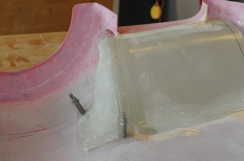

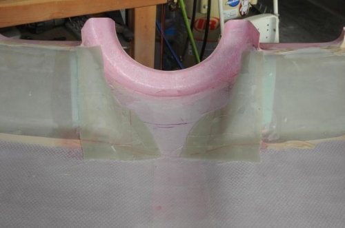

Brief Description:  Cowl ramp mod 4
Ramps cured ... I pulled the peel ply, and gently removed the new ramps from the cowl. Pulled the clay out and cleaned up the cowling. Trimmed the edges of the ramps and sanded the rough edges and bumps. Scarfed teh edges of the the ramps and laid in a bonding scraf as well as a flox mixture to bond the ears to to the cowl. Looks nice!
Loosly trimmed ramps
Final fitting
Final fitting
