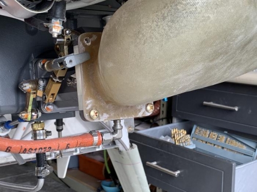

Brief Description:  Snorkel fitting 1

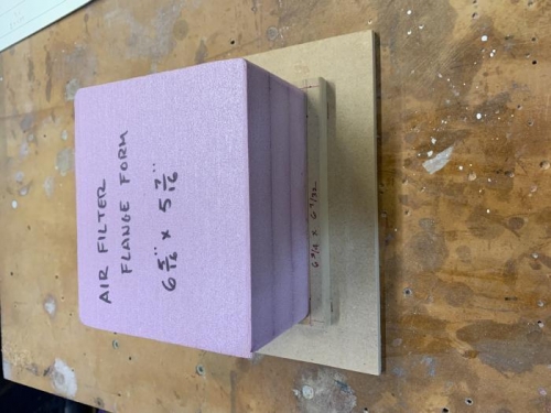

Drilled snorkel base flange; I made sure that the snorkel clears the starter motor mounting ears, etc. It doesn't fit all that well on filter end ... Looks like I'll be building a franken snorkel. Started by building a form for a glass flange for the filter, rather than using the aluminum bendies provied by Vans. Apperently, the -14 has one of these flanges
Shop visti with Pat Carr - Has a nice, flying RV-7 at HAF
Snorkel fit at the ramp ... too outboard and forward
Flange drilled and trimmed
Start fo the form for the filter that will mount to the ramp.
