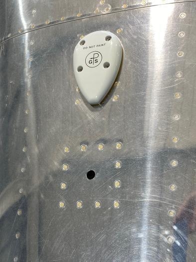

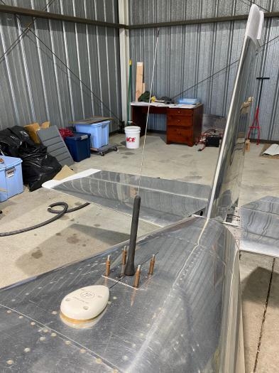

Continued with a condition inspection of the airframe. I ran a self test on the new 406 MHz ELT, and the unit (Artex 345) came back with an antenna load failure (4 beeps). The location in the baggage compartment is very sub-optimal, and I elected to move the antenna to the top of the fuse near the GPS antenna. The system self-tests OK there.
Drilled and added a doubler with the help of next-door hangar neighbor Brian. Need to run a new coax to the ELT from here.

New antenna location
Doubler rivited
Doubler rivited
