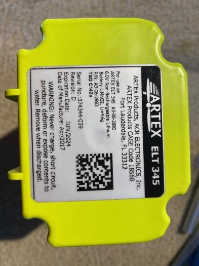

Based on ELT battery data, MFG date: 4/17, expires 6/24 puts half useful life at 11/20 (six more months). ELT batts expire 11/2020.

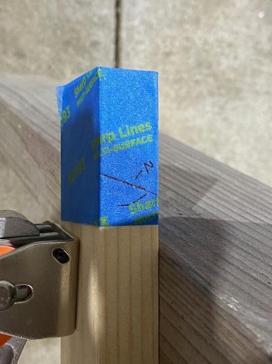

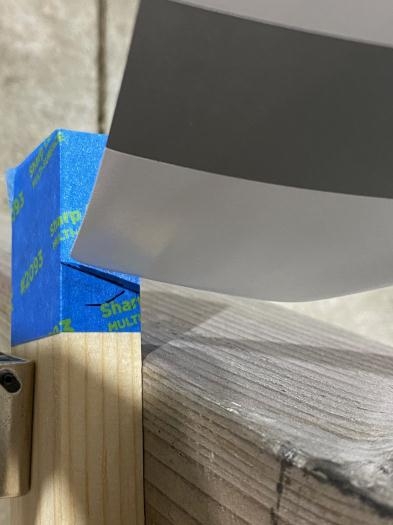

Performed a prop blade tracing test ... result is that the prop blade offsert is < 1/64 of an inch .. on the money!
ELT battery data plate
Offset between blade 1 and blade 2 <1/64"
Marking the offset.
