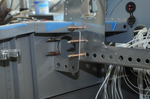

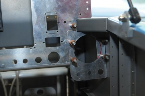

Brief Description:  Air vent and headseat brackets
Designed and fabricated the brackets to hold the Stein air vent eyeballs and the headset jacks (both conventional and Bose LEMO style)
I needed to remove the fuse skin mounted ears and remake new ones to fit the location of the mounting holes surrounding the eyeball vent. This took few iterations and some dremeling on the bracket and panel to give the proper relief.
These should look nice and clean when completed.
