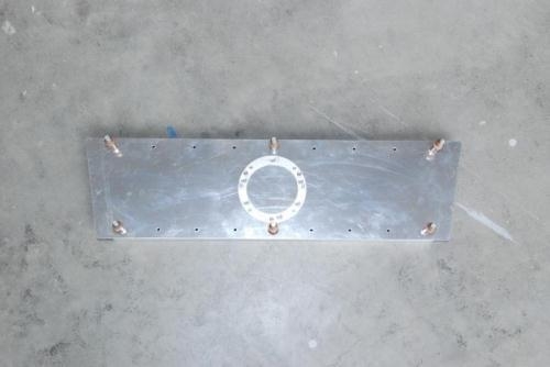

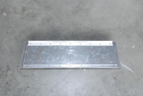

Brief Description:  Magnetometer shelf
After some research on VAF, I decided to build a shelf for the magnetometer to mount across the longerons behind the F-708 bulkhead. This will be a nice and rigid mount, and about as far away as possible from magnetic disturbances.
I elected not to mount it in the tail like some other successfully have done, to keep it relatiely accessable for maintenance if needed.
