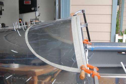

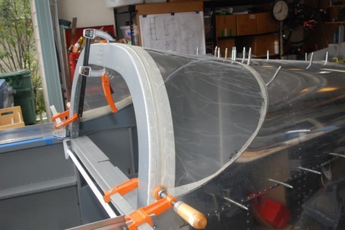

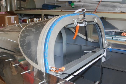

Initial fit of rear canopy
Fit check of the rear canopy. Slip the plexi in and clamp in place. Mark the trim line and skin edge lines for future reference. Remove, sand hoop edge and then polish with multiple grits up to 400 until "clear".
