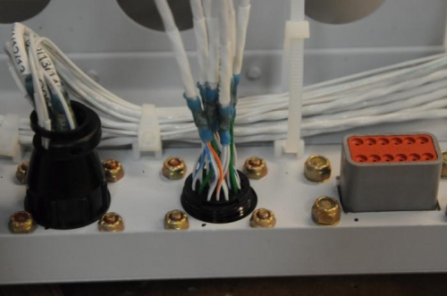

Tray wiring 1
Started to wrie up the tray connectors. I set up the stripper to strip the "perfect" amount of insulation for the 20 AWG contacts and got out the heat gun for the TSP termination solder sleeves. A somewhat slow but relaxing process.
