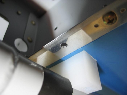

Brief Description:  Drill flap center bearing block.
Drilled the flap center bearing block up through the floors and rib. I had to remake this bearing block because the first one put the forward hole to close to the web of the bulkhead.
The drawings call out platenuts for these bolts but we have easy access and I’m contemplating just using a nut. What do you think?

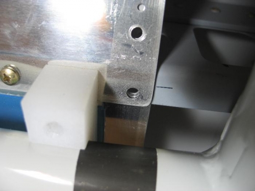

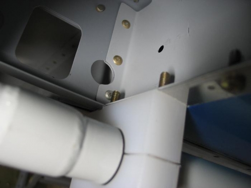

Image 2 and 3 show the forward and aft bearing block attach holes that were drilled through the bearing block. I’m happy with the locations.
Flap bearing block drilled.
Forward bearing block attach hole.
Aft bearing block attach hole.
