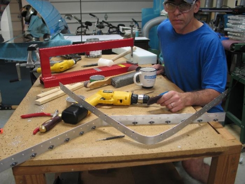

Leading edge joint plate, Part3.
Here are the jount plates completed.
I dimpled the holes that attach to the rib after all pate-nuts were attached
Holy moly, these guys took a long time to complete.
Edge finishing,
28 #8 screw holes
56 plate-nut attach holes.
56 plate-nut counter sunk holes.
56 plate-nut attach rivets.
56 rib attach holes.
56 rib attach hole dimples.
Joint-plates complete.
