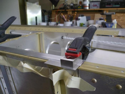

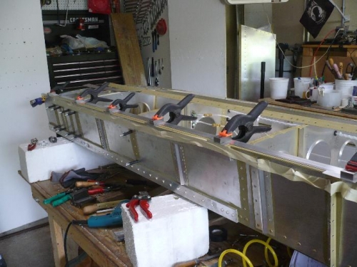

Set spar cap height and clamped in place (clamps not shown here). Add the clamps close to the shims. Lightly clamp and use shim as a feeler gage, tighten and tap into place using feel. Tighten clamps and drill through.
Drilled #12 through spar cap angle
.5mm space up above spar
Add C-Clamps
Add C-Clamps
