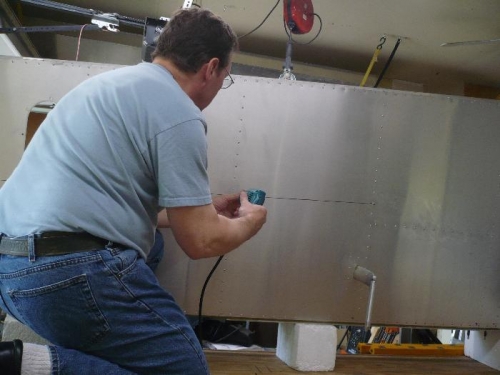

Working on rear spar
Drill L-Angle holes
Deburred parts for the rear spar

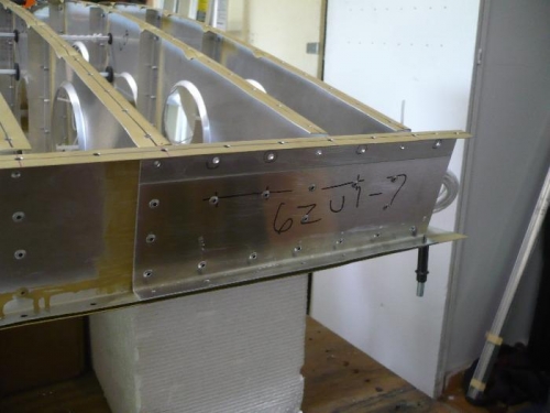

Replaced Hinge Doubler with 6ZU1-7
Added 6ZU1-8 Aileron Rod Hole Doubler and placed aileron stop below it to keep aileron stop in the same location for proper deflection.
