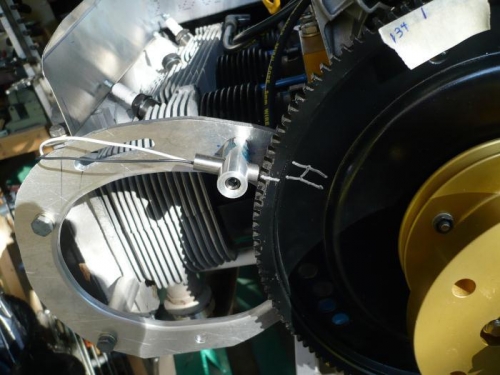

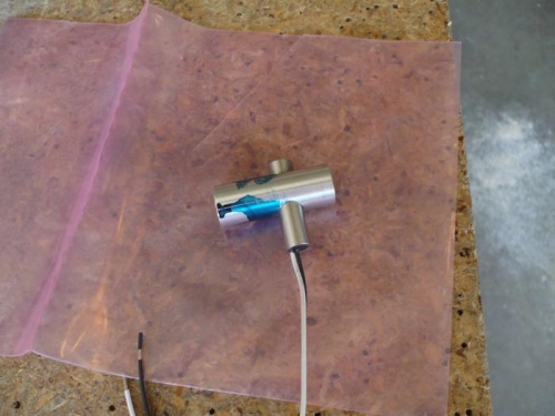

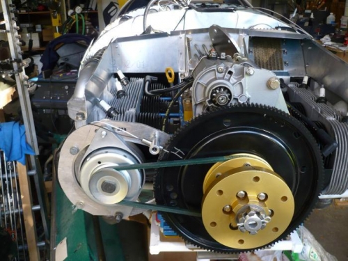

Tack Pickup mounting
Still got the cold, more miss than hit today.
Made per pg 110 of the WW 601 2007 Installation manual. My 1.25 dimension is really 1.055 but otherwise, just like the print.
Found the highest tooth and set that to .010 clearance. Used a round disk of neoprene under the set screw to prevent maring of the pickup body.
