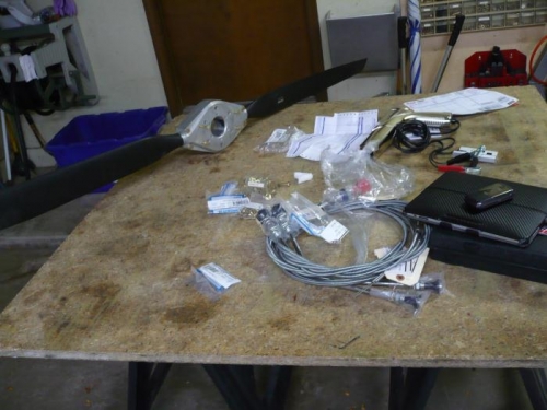

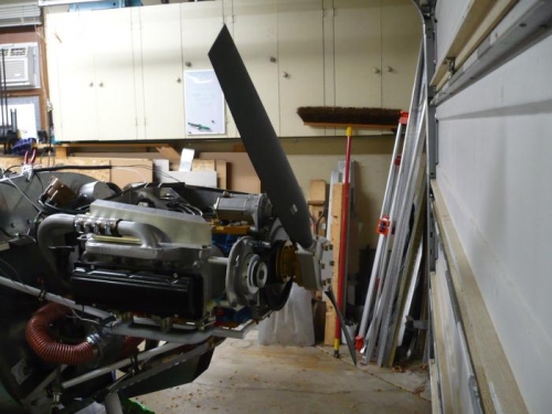

Set upthe Warp Drive prop
Had to remove some of the OD of the Crush Plate to clear the bolt heads of the AN4 bolts.
Have it pitched 8.5 degrees with the smart level.
