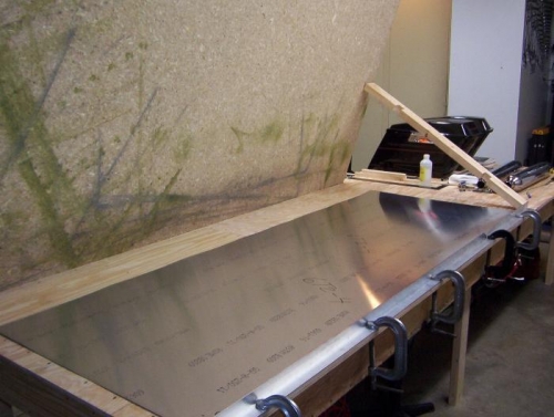

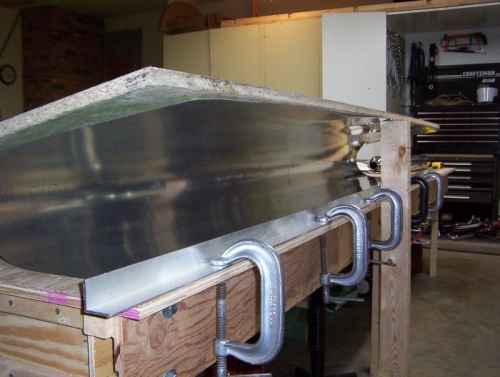

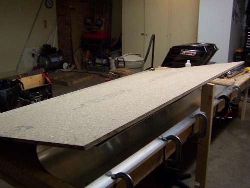

Forming Stabilizer Skin step 2
Prop open the MDF so you can lift the edge of the sheet metal. Remove toggle clamps from back stop angle. Carefully lower the MDF and sheetmetal edge so they line up. Use support to hold the sheetmetal/MDF open.
Next
Prop open MDF sheet
Match edges MDF & Sheetmetal
Use support to hold open
