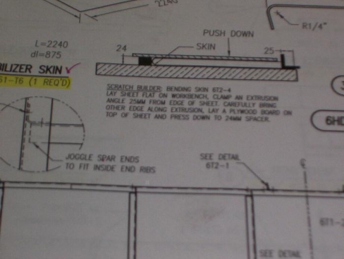

Manual Reference:  6-T-2

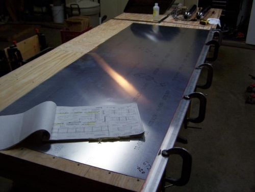

Brief Description:  Forming Stabilizer Skin step 1

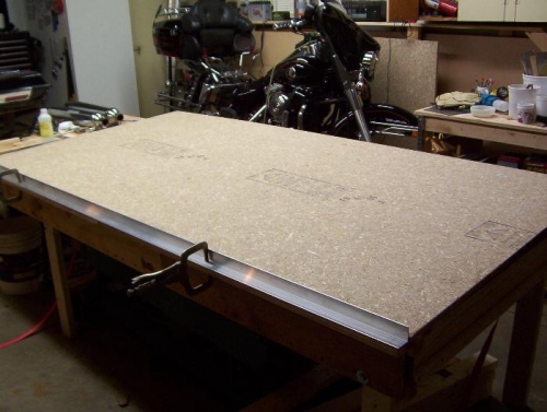

The next 4 entries will show the sequence of steps for forming the stabilizer skin. Step one mark the sheet metal 25mm and line up the algle to the marks, Bring angle edge to edge of table and clamp angle to the table sandwiching the sheetmetal between, keep the marks lined up. Toggle clamp the other angle to the other side of the table and lay the MDF on top of the C-Clamps and butted to the other angle. Materials: one flat table, two 2" x 2" x 8' aluminum angles, five 6" clamps, one 2" x 4" x 4' support, one 3/4" x 4' x 8' MDF sheet. three spacers 24mm high.

Clamp metal to the table

Just like the directions say

Clamp other angle on other side
