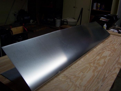

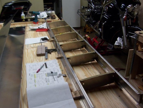

Brief Description:  Fitting Stabilizer Skin
Attach stabilizer skeleton to the table top side down and front towards the edge of the table. Used 1 x 2 spacers screwed to the table along the table edge to support the front stabilizer spar and clamped the rear stabilizer edge right to the table using plywood and screws.
Layout and trim the cutouts for the lower front attachment points using the 233mm spacer 304mm up from the lower edge of the stabilizer skin.
Attach Skeleton to table
Layout & trim the cutouts
Fitting stabilizer skin
