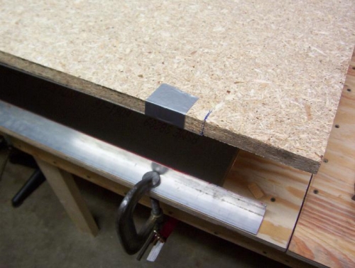

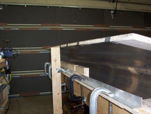

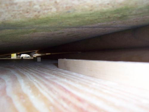

Use duct tape to attach the sheetmetal edge to the MDF. Mark the end of the sheet metal up to the top of the MDF and also make a line up the angle, you will use these when you close up the end. Place the 24mm spacers about 4" away from the bend line.
Duct tape edge to edge
Edge taped
Edge taped
Place 24mm spacers
Place 24mm spacers
