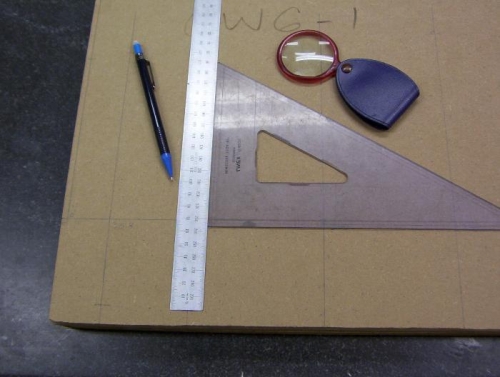

Brief Description:  Layout Forms
Image 1, shows the tools I used for marking the lines. .5 mm Mechanical pencil, 300mm long .05 incremented scale, 30-60-90 triangle with parallel lines scribed at .060 and .125 from each edge (allows for quick accurate positioning of the triangle), and a Magnifing glass (the eyes aren't as good as they used to be).
Process: Square up the triangle, Position the scale .5mm less to allow for the lead diameter, strike a mark on the verticle line.
