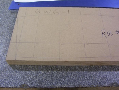

Brief Description:  Layout forms

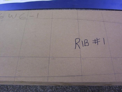

Process: Layout grid using straight edge along longest line, in this case it was the horizontal zero line. Next layout the perpendicular stations i.e 100, 200, 300 . . . etc. From each of the intersections measure the distance up and down at each station and place intersecting marks at the correct distance on the verticle lines. Continued next entry--
Layout grid
Layout grid
Station Lines are verticle here.

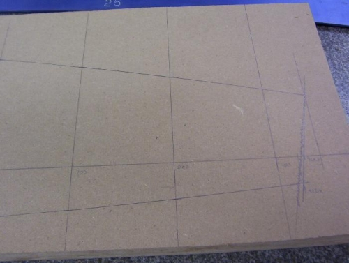

Correction on end trim.
