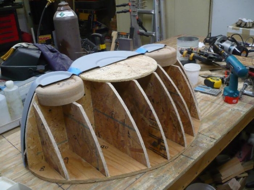

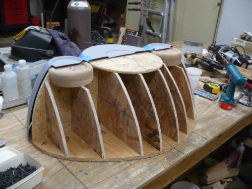

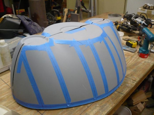

WW Nose Bowl
Blended several stations and re-made one
Checked for tangent to tangent blend and had to trim the 4 middle ones to get a good blend.
Station 9 had to be remade, the tangent blend was an under shot by 1/4".
Need to cut in the center relief for the prop hub opening but other wise it is esentially ready for metal.
