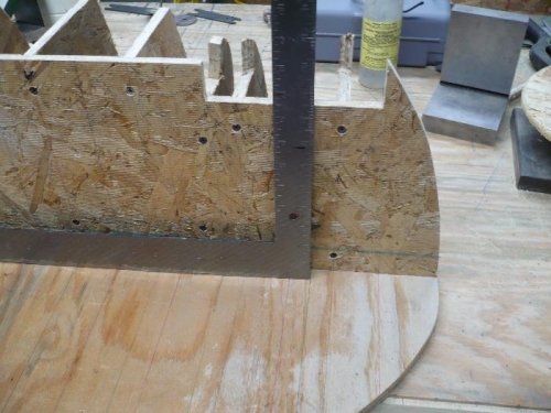

Layed out square lines for station locations on the base and back bone.

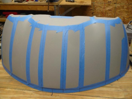

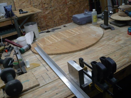

Disassembled buck, screwed base down to the table on the original layout, and transfer the lines back to the table edge.
Removed base from table, aligned part and taped areas for the pen marks. Transfred the lines onto the surface of the part.
