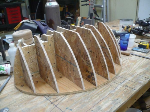

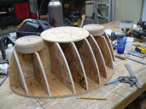

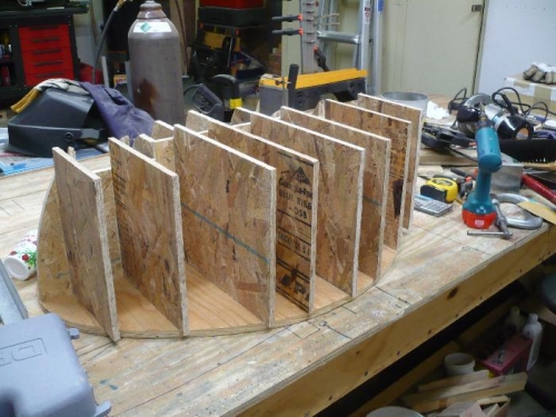

Took everything apart and sloted backbone and base for the bottom stations. Reassembled and set stations in their slots.
I was able to use two of the prior templates to capture the shapes from the part station lines. That made the layout go much faster.
Trimmed the forward ends so the disks can sit on them.
