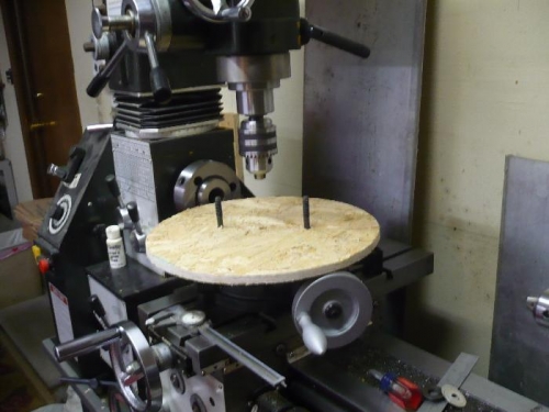

Setup the disk on the turn table and cut diameter to size.

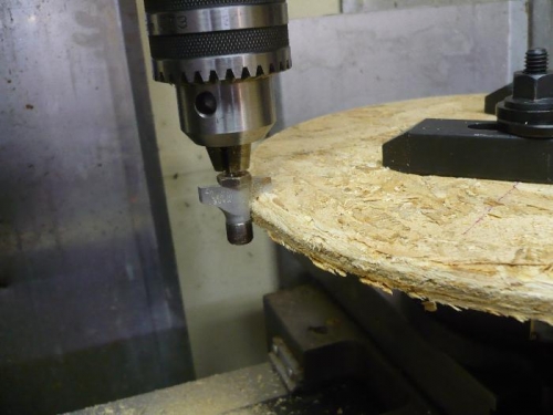

Put 3/8" radius around disk.

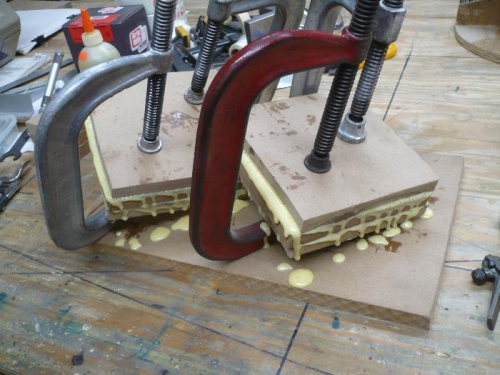

Cut and glued 7" squares of 3/4" MDF to make the inlet shape disks.
