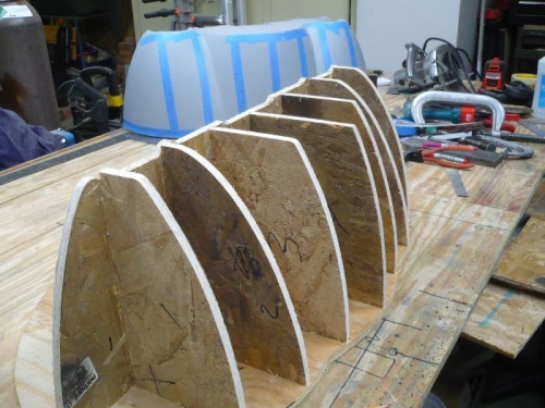

Brief Description:  Trim stations for top of Nose Bowl
Trimmed and sanded the stations for the top of the Nose Bowl. Still have two diagonals to make between stations 2 - 3 and 5 -6.
Made 13" dia piece and sanded it to line. Drilled 1/2" hole throught center to help align it to the lower pieces. Line up the hole and the lines transition correctly on the three middle stations to the disk.

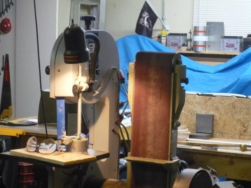

The cutting and sanding is pretty messy and I had a respirator on the whole time.
Line transitions to disk
