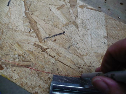

Brief Description:  Extend the lines on the stations

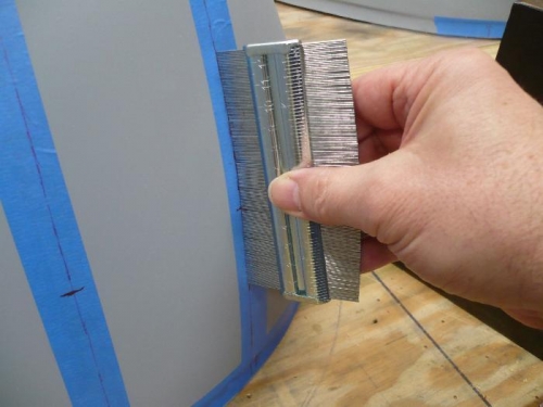

Marked the contour tool about 1/3 up and aligned that to the point of the end of the first line segment. I will use that small section to continue to extend the line up the stations.

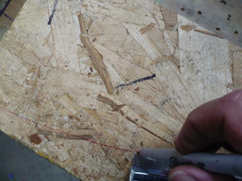

Adjust the placement of the short segment carefully, use the pen point to align each end and hold the pen at the same angle when you draw the line.
Drew line segment on all the top stations. Will cut at next session.
