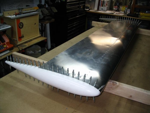

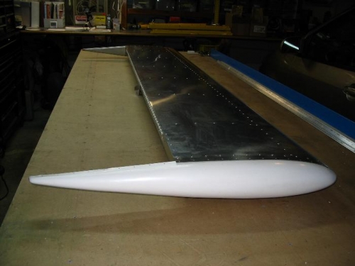

Brief Description:  Riveted tip ribs and pre-drilled fiberglass tips
Even though the fiberglass tail tips do not get installed until after the stabilizer is installed on the fuselage, I decided to fit and pre-drill them. The installation took more time than I imagined, but it went well. The distance between tips came out to 2205mm, as called for in the plans. Now on to the elevator.
