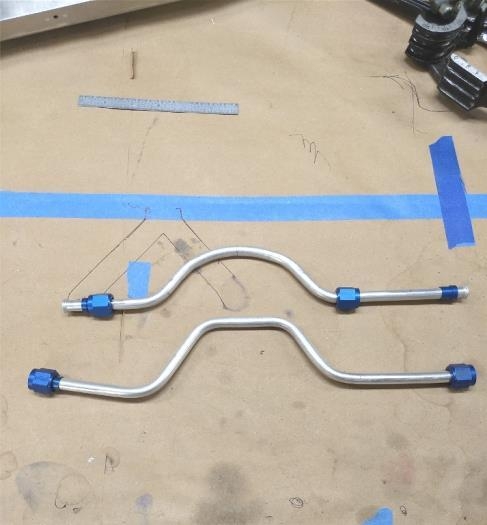

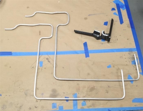

Brief Description:  Fuel line fab and routing
Rough out fuel line routing and fabricated the lines. First made very rough physical models to determine lengths and radii then fabricated the final version. Only once did I flange an end before installing the nut and barrel - a personal performance first!!
After making the final install, decided to see if the seat pan would fit. It didn't - one point of minor interference so it was time for wine.
