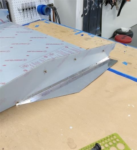

Brief Description:  Installed strakes
Drilled for mounting the stakes that attache to the turtle deck. Final installation will have to wait until paint is complete and that will have to wait until warm weather returns.
Fabricated the fuel line between the fuel cutoff valve and the firewall passthrough connector.
Installed a Adel clamp that mounts the oil pick up hose to the oil cooler mount.
Installed the starboard carburator.
Strakes match drilled to final size
