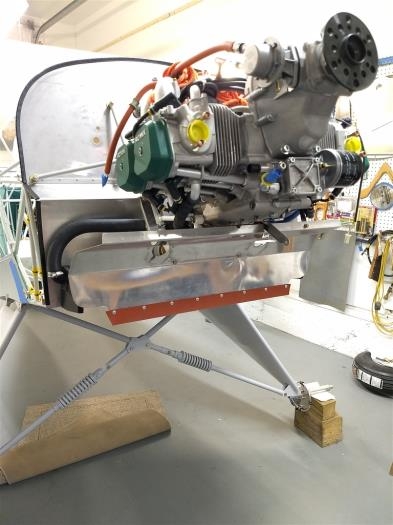

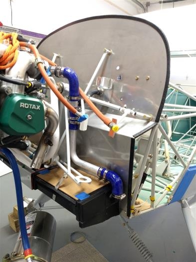

The parts to complete the cooling system finally arrived and the installation of same completed the cooling system.

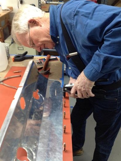

Decided to install a gap seal on the lower section of the cooling baffle. Maybe there is a good reason that the manual doesn't call for one - but I can't think of it and would like to make sure the cooling system is fully functioning. Also, I'd like to think it may reduce cooling drag a bit.
Cooling system completed
Installing gap seal
Installing gap seal
