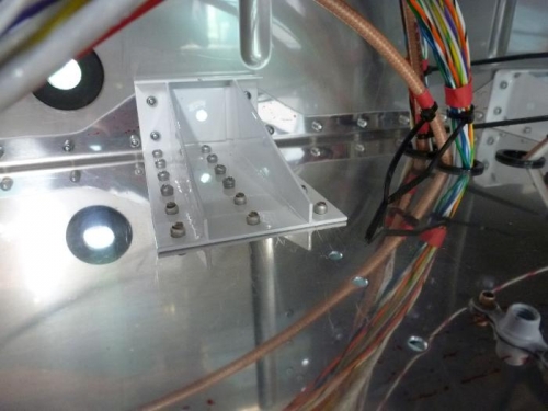

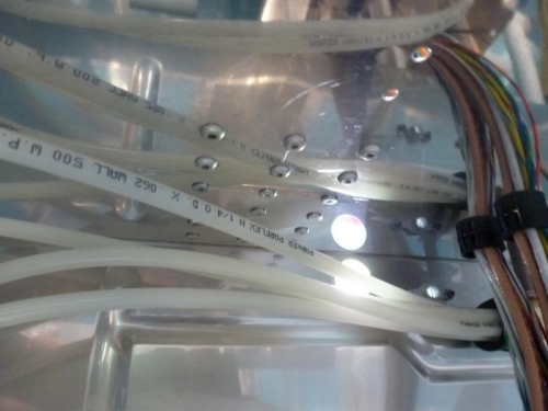

Service Bulletin 16-08-24, drilled out existing rivets and replaced with Cherry rivets. Will still inspect at annual. Completed this now during construction instead of waiting for inspection and a problem.
top view left engine mount

bottom view left engine mount
