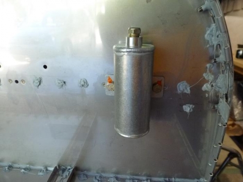

Manual 32-02 steps 1 - 3, mount the brake reservoir, torque to 35 in/lbs, apply torque seal.

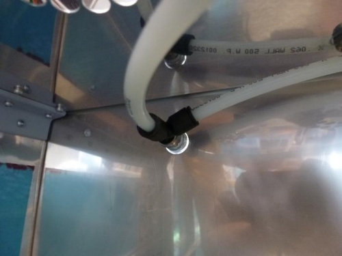

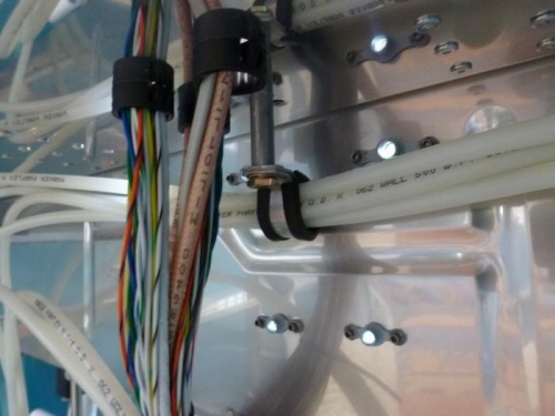

Connect brake lines. Had ro reroute lines behind the wiring.
Install brake lines clamp, torque to 35 in/lbs.
reservoir in engine compart.
reservoir connections
brake lines clamp behind wires
