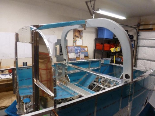

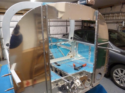

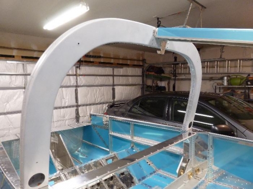

Manual 24-05 steps 1 - 6, rivet nutplates, rivet rear bulhead parts, install and rivet upper bulkhead to rollover assembly brace, install doubler near where fuel will be. Did all riveting with hand tool.
Looking ahead and deciding what to do about painting the interior. Since I plan to have the plane professionally painted and will have full upholstery I plan to do minimal interior painting at this point. I will prime and paint with rattle cans the areas where the rudder peddles will be installed and examine pictures of interiors to see how far I need to cover. I will probably just prime in the tunnels that will be covered with access panels.
