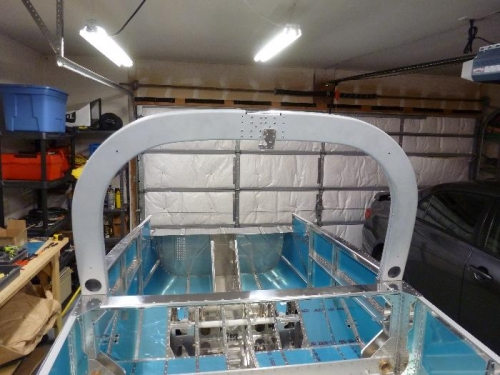

Install rollover assembly

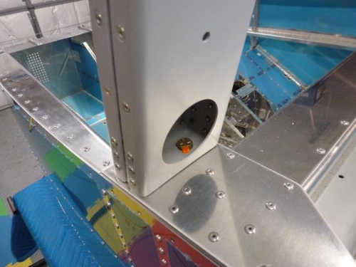

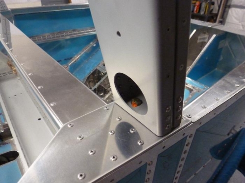

Manual 24-03 steps 4 an 5. Bolt the rollover base mounts, torque AN4 bolts to 85 in-lb, apply torque seal, rivet rollover assembly onto bases.
rollover assembly
right base, see torque seal
left base, see torque seal
