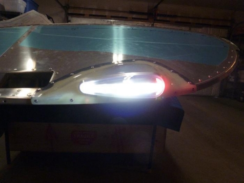

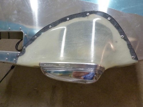

Manual 40-10 steps 2 - 7. Add tape to mask the wing. Add fuel tank sealant and cleco and rivet. Used fillet tool to clean up. Removed the tape. Very pleased with the result

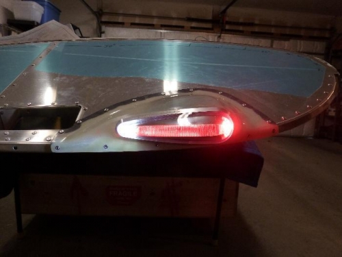

Manual 40-10 steps 8 - 14. Wired the left wing tip light and tested with a 9 V battery. Tested via the complete wing wiring back to the wing/fuselage connector. All works great and looks great.

left wing tip light
left wing tip light
left wing nav lights test
left wing light test w/strobe
