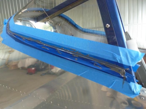

Brief Description:  finished install of rear window
Manual 25A (used 38iS/U-14 steps 2 - 10. Tape the rear window above and below the joint area on the outside and below the joint on the inside. Used the epoxy fuel tank sealant fron Vans PCI CS-3204 B-2. Just used the nozzle that came with it to apply the caulk sealant. Used the modified tongue supressor to smooth out the sealant. Let it sit for a while to cure some. Removed all of the tape and dia little cleaning up.
Alsoin the mean time I used some of the sealant around the iside of the fuel filler inlet to make a better seal.
rear window taped
rear window taped

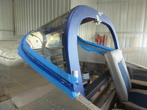

rear window caulked
rear window caulked

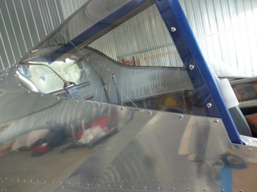

tape removed
tape removed
