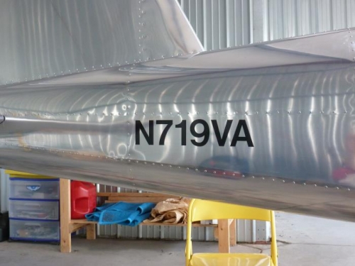

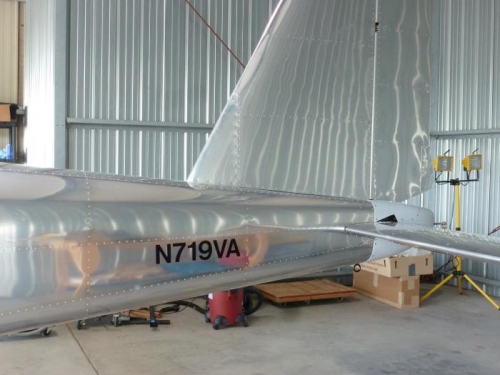

I then applied the two registration ID numbers on either side of the fuselage.
N number right side
N number right side
N number left side
N number left side
