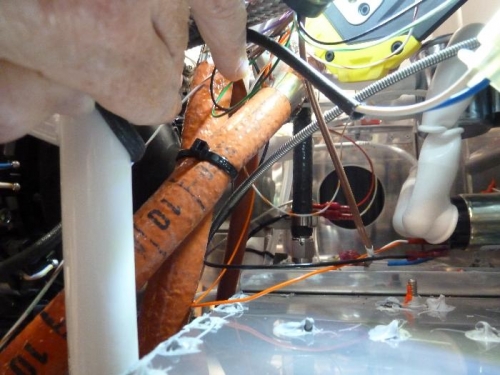

finish oil hoses, start install of throttle
Manual 49-17 step 6 finish - wiretied the VA-213 and 215 hoses together, verified all oil 6 hose fittings are tight.
Applied a small amount of clear RTV to bottom seal of air duct to allow for proper sealing when the cowl is installed.
Manual 50-02 step1 and 2 grind flat edge on throttle lock washer to clear the bottom portion of the instrument panel.
wiretie on VA-213 and 215
