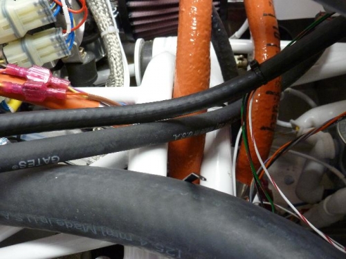

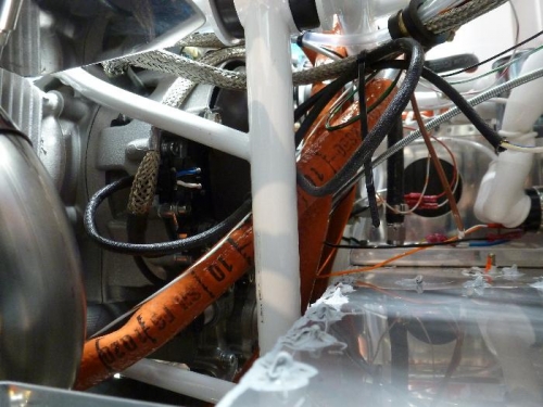

Brief Description:  talked to Vans on the oil hoses
Talked with Tony at Vans about the VA-213 oil hose and twisting. He sent a drawing to show the fitting clocking.
Manual 49-17 step 6 I re-examined the drawing very carefully for routing of the VA-213 and VA-215 hoses. The clocking of the hose fitting was fine so I knew I must route them differently Finally got it right after moving VA-215 to the other side of the gascolator fuel line hose and reinstalled the VA-213. Tightened hose firrings, set gap on VA-214 from the cowl.
VA-213 and 215
VA-213 and 215

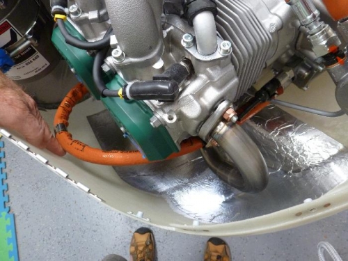

clearance VA-214 to cowl
