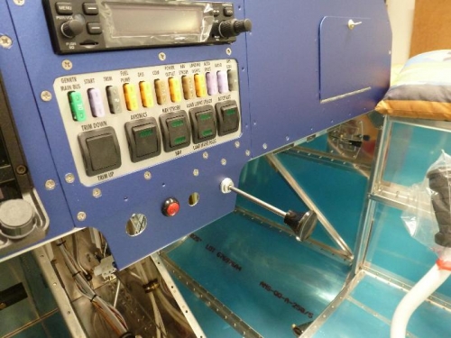

Manual49-08 steps 1 & 2, install heater cable knob into instrument panel.

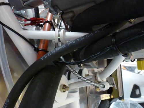

Manual 49-09 steps 1 - 4, attach heater cable with clamps to the engine mount. Used safety wire to hold clamps tight.

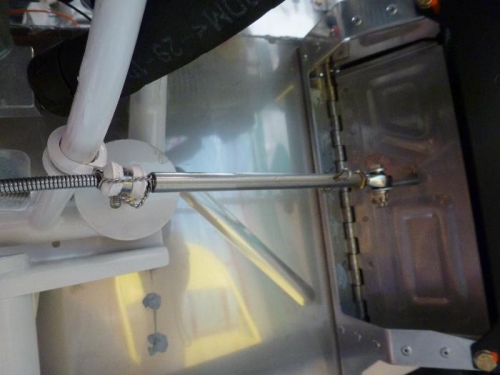

Manual 49-10 steps 1 - 4, connect heater cable attachment to the heater door. Tightened lock nut on the tube and applied torque seal. Safety wired the cable across a clamp.
heater cable/knob installed
heater cable clamped
heater cable attached to door
